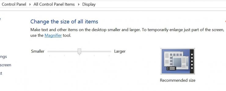

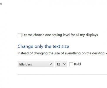

Which Scaling Option are you using? Are you using the legacy % Radio Button or the Windows 8.1 Slider? I find using the Slider my text isn't blurry (if the legacy app still is blurry I disable Scaling on High DPI)...
Legacy:
Windows 8.1:
