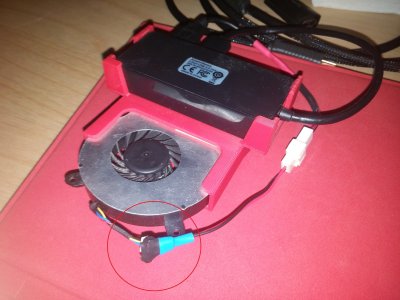

Hey,
I am interested in getting this custom fan, but there is one thing that I don't understand.
Sorry if it seems so obvious to other people, but I do not understand how is this part connected on the photo. Could you please explain to me how did you do it? Thanks in advance!
The part you have circled is that fan connector and plugs directly to the fan. It is listed in the OP and needs to be soldered to the usb cable.
