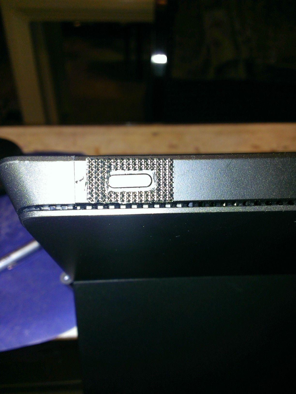

FWIW I have made a low tech, low cost workaround, to the power button on the Surface 1 &2 (I wish they had recessed it a bit more) being inadvertently pressed at inopportune times. For example, careless handling, movement or inadvertent contact in my carry case etc. These events can lead to battery draining and/ or heating up excessively. It provides a margin of safety for these events as well a quick tactile locator in obvious situations.
Material: Velcro adhesive strip (plastic textured surface)
Cost: < 1$ YPMV
Shape: Rectanglar
Outside dimensions: 20mm x10mm
Inside cutout dimensions: 12mm x 5mm
View attachment 1691View attachment 1692View attachment 1693
That almost looks good except I cant make out how you implemented it.
This was for my SP2.
wp_20140224_005-jpg.3570
He took the stiff/prickly side of some beefy self-adhesive Velcro, and cut a hole out to match the power button area. Then stuck it on there. That way the Velcro is actually a tad bit higher than the power button itself, and now the button can't be actuated unless a finger is pressed straight in.
Unless I missed the point of your question...
I would be hard pressed to describe it any better,
BTW I have not had any incidents since implementing this
