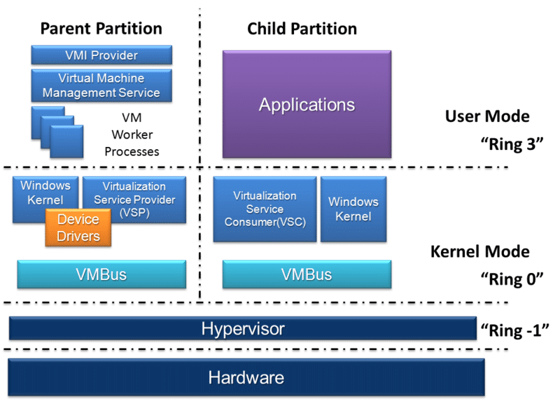

Hyper-V is not activated by default, people recommended it because they didn't like that Microsoft had limited Power Profiles because of Connected Standby. If you were running on Hyper-V you needed to enable it.
Hyper-V is a Type 1 Hypervisor (hardware based) that allows you to run multiple Virtualized Workloads on the device. Typically for Dev or Test Work. Hyper-V is installed and loaded prior to the OS and is an abstration between the Host and Hardware.

Here is a simplified view of what Hyper-V does when enabled on a device:
It is a Server Based Technology that has been shoe-horned into the mobile space for specific scenarios and is not fully optimized for the hardware, as I said earlier it is an abstraction layer above the Hardware and the OS now lives on top of the Hypervisor, so there is additional overhead.
