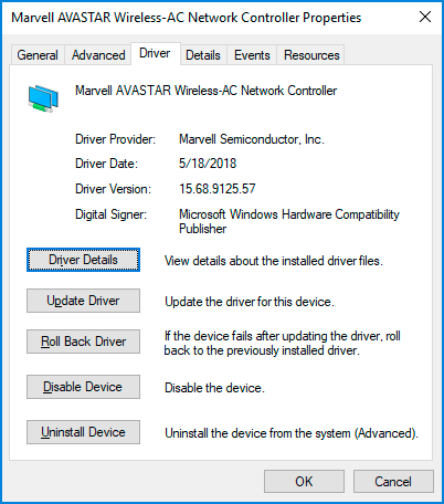

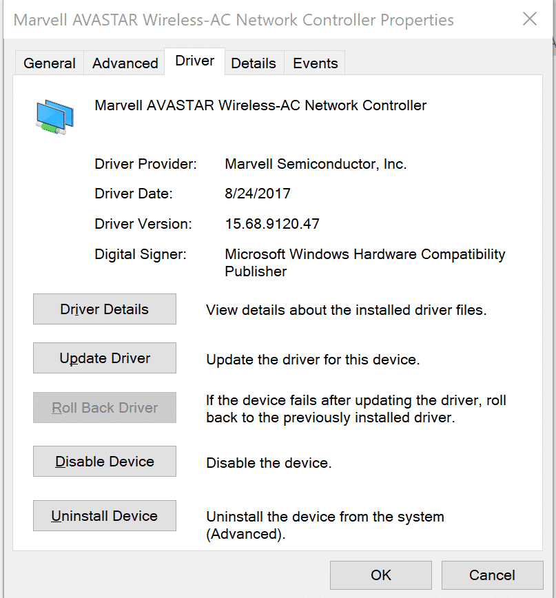

@CrippsCorner ,
Must be annoying.
I've included my settings just in case you may spot something on your end ...
Hmmm. My driver and its files seem to be more current than yours:
Yours:
annotation5-png.9072
Mine:
My guess is that a routine Windows Update did that? I don't recall manually doing any driver update. Next time I encounter the problem, maybe I'll roll back the driver to see if that's the problem.
