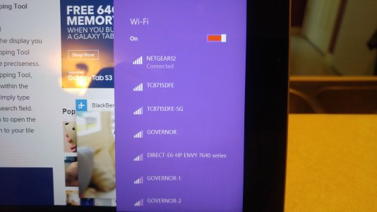

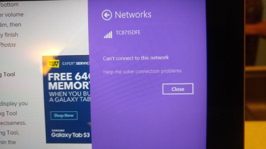

Sorry I have not been back sooner. The Surface sees the SSID network. I have tried to manually enter the network the encryption type and the password. I have also tried the automatic configuration WPA button on the router. The Surface sees the router and it gets information from the router but it is unable to connect to the network. Back to you first answer. I can change the mode from 802.11 b/g/n to 802.11 g/n or 802.11 n. I tried to change to 802.11 g/n and it still could not connect.
I tried the router reset today and the Surface still will not connect. I am wondering if I should back up and restore the Surface and see if that helps.
Thanks,View attachment 8510 View attachment 8513
