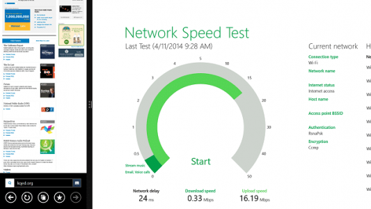

Whenever I pair up my speakers via Bluetooth my WiFi download speed plummets to a crawl. I tried it again after the update and it's still bad. bad wifi.png
Any suggestions?
Use the 5Ghz Spectrum for your WLAN and Bluetooth won't impact your speed....Contention on the 2.4GHz is high on the Marvell Integrated Wireless Card.

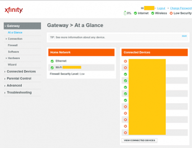

Ok, so what I'm hearing is when I ever I use bluetooth and it's going to interfere with the wifi from this router.... bummer. OK, well at least I have some answers. I don't think I'm ready to dish out that much to own a router. I'll get a hold of comcast and see if they have another renting option for me.
