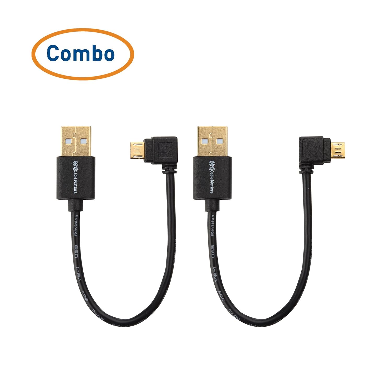

Instead of buying an additional $40 charger when all I need is the cable, where can I get a charging cable that will allow maximum charging speed and also has the similar slim 90 degree angle so that it won't protrude out when plugged into the Surface?
I'm looking for something that will be ideal for recharging with a battery pack while the Surface is in a bag.
Standard cables stick straight out and force you to bend the cable awkwardly to fit inside a tight tote bag which may cause the cable connector to fail quickly.

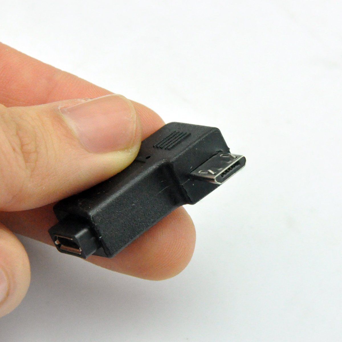

I see adapters you can buy, but I want to make sure any 90 degree micro usb adapters will not cut the charging speed.

My question is mostly about finding an alternate cable that has a low profile when plugged into the Surface so it fits in a tight tote bag without having to severely bend the cable where it connects. Otherwise, I may just order another Microsoft charger including the brick, but that seems like could be a waste of money.
If I have a straight micro usb cable that works for fast charging when used by itself, can adding a right or left angle 90 degree adapter as shown in the second photo above cause it to drop down to slow charging?
