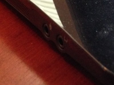

Again, here is where the Dell S2340T comes in handy. Its got both the Earphone and the Microphone in 3.5mm Jack on the left front base edge.

Thanks for the feedback (thus far :) ). Incidentally, I had to pull out my Touch Cover to reply to this today. For some reason the on-screen keyboard would not stay on the screen. It would slide-up, and then slide right back down :( . Machistmo, is the Dell S2340T a monitor or some kind of dock? I actually would rather a combined port, that way the iRig would work :) . If a phone headset works with both the microphone and the speakers in a headset for Skype, that is a pretty good indicator that it is a headset jack vices just a headphone jack. If I can figure out a way to test out the iRig prior to buying the software, I'll post back here with an update. Thanks again everyone!
