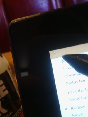

here is an attached picture of the problem, i tried calibrating a couple of times but it didn't do anything about the problem. its only a problem on the top left corner and only about a square 1/2 inch is effected but it happens to be were the back and forward buttons are in IE, so i commonly hit the wrong one. can some one hold your pen at an angle like your righting in the top left corner of there surface pro and see if the cursor slides away from their pen tip. in the attached picture my pen is fully touching the glass IMG_20130924_104305_026.jpg
Your device may be defective. If I were you I'd try to get a warranty replacement.
