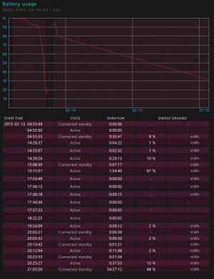

Normally after 4 hours of CS the Surface 3 switches to light hibernation right?
Mine doesn't:
currently /sleepstudy only gives an error -.- therefore this screenshot is the onl thing i have.
I knew that it was working as expected a few weeks ago.
i cannot remember any settings i could have changed to deactivate this!
this is the 2nd time such a thing has happened.
Anyone has an idea how this comes?
Or how it's easy solved?
Reseting / clean install is currently not a thing i'm looking forward to.

SOLUTION:
as mentioned by Goldfinch711
Open CMD as Admin and enter the following:
This worked for me
